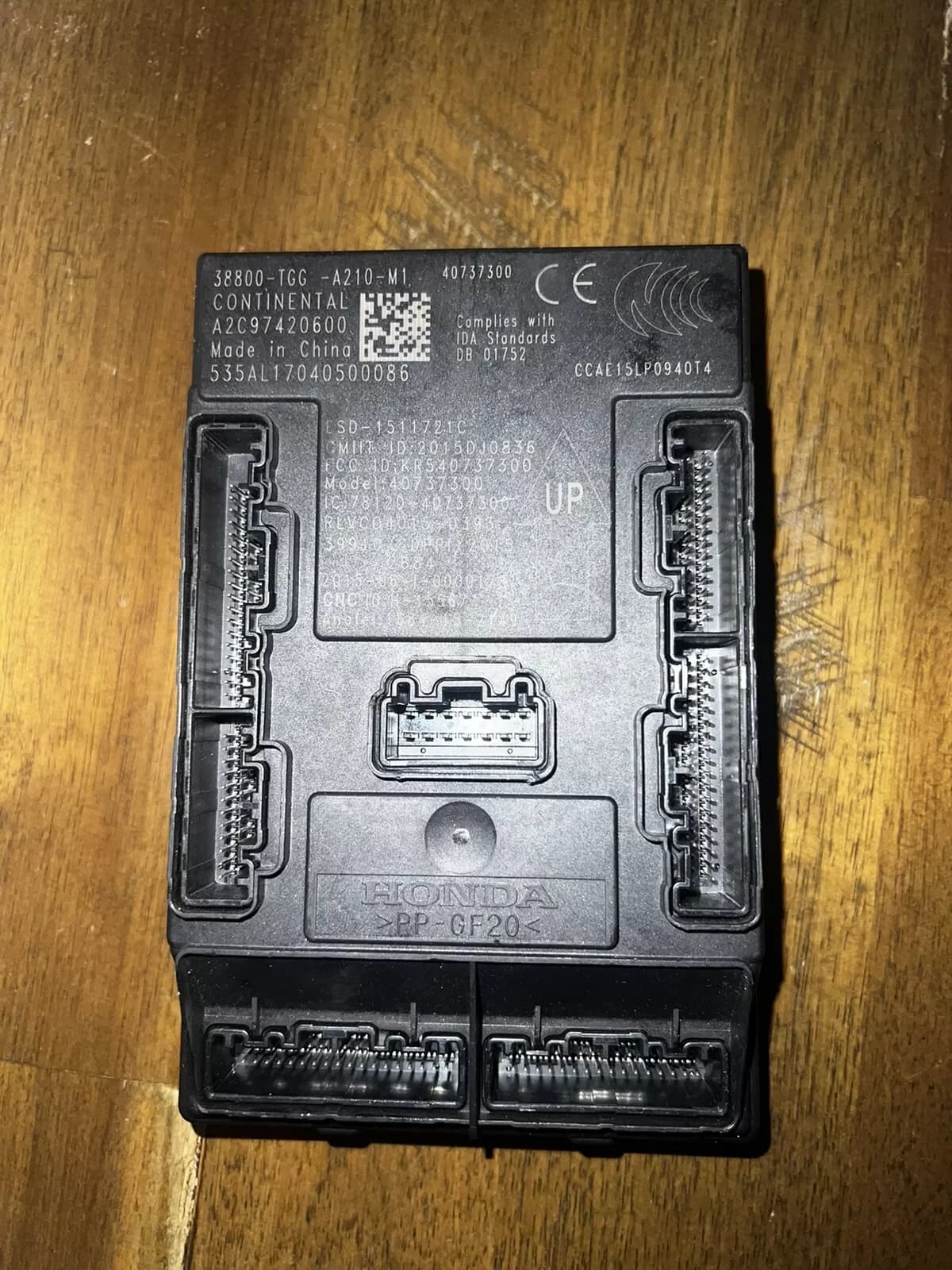

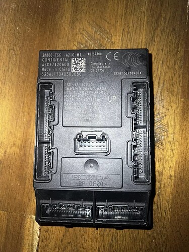

Honda says it’s the MICU (a control unit located above the fuses, behind the steering wheel). The estimate to replace it is €1,900, and it’s something you can’t do yourself because this control unit manages the immobilizer and needs to be reprogrammed for your remote once replaced.
In all the cases reported in American forums, upon opening it, they discovered what appears to be water residue inside the control unit.

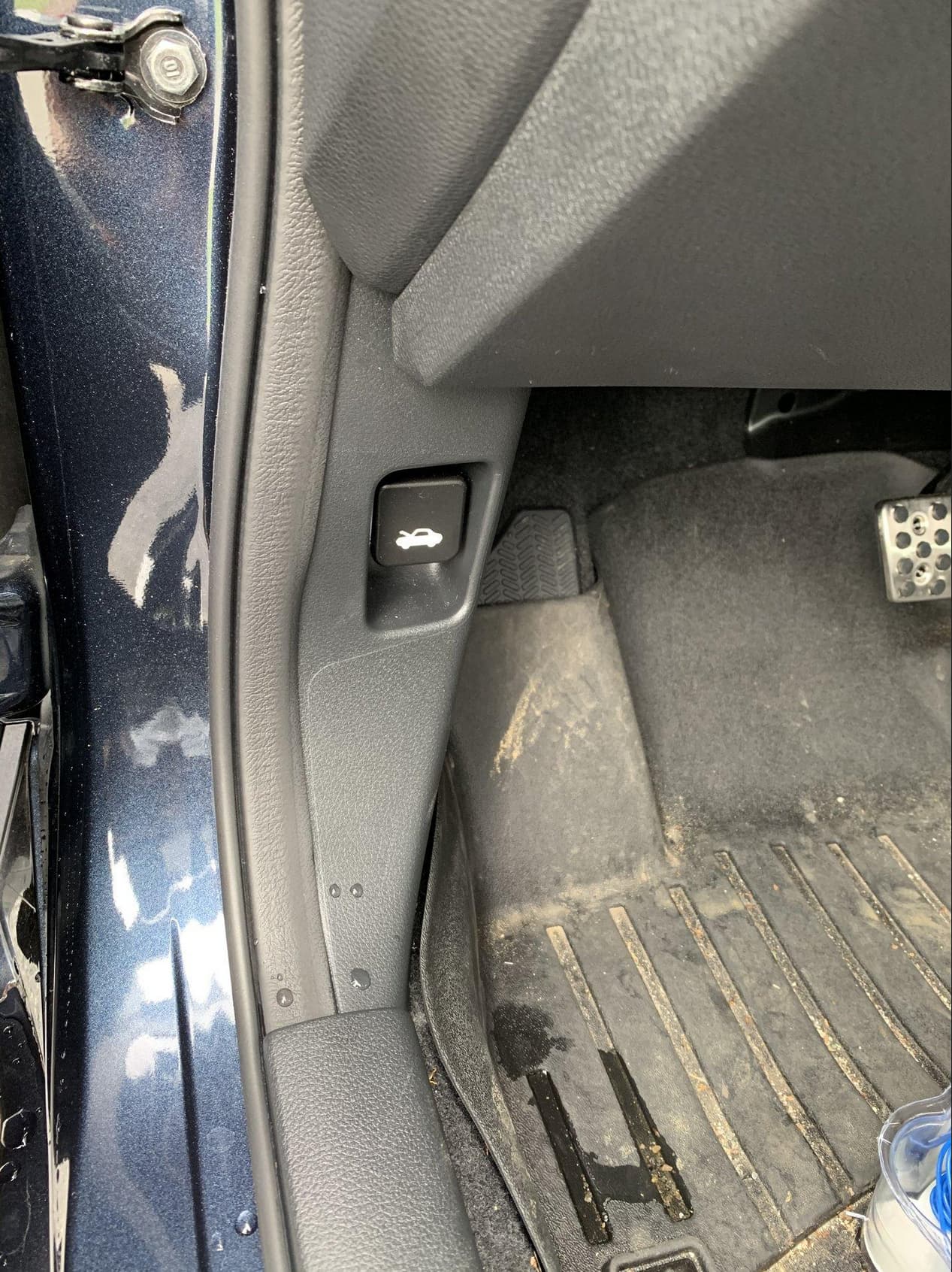

Do you have a picture of where that control unit roughly goes?
Above the fuse box under the steering wheel. If you look closely, you’ll see it; it’s the small control unit with all the cables connected. It’s this one:

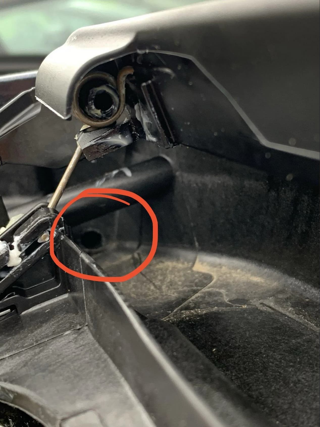

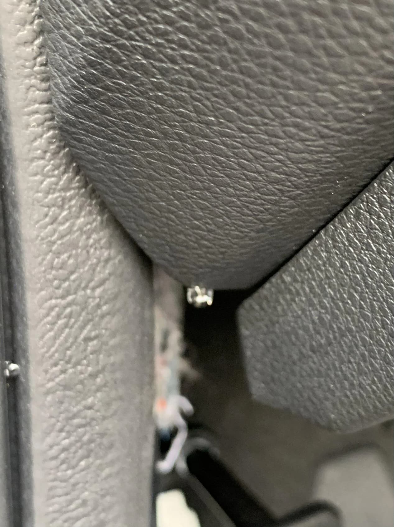

Here are some photos from the thread
But in that thread, it later mentions, upon solving it, that it was a problem with the sealing of the windshield on the lower part.
