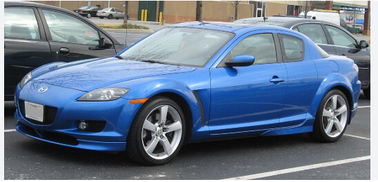

As you can see, the RX8 rims are a steal and are among the lightest on the list, around 9.5kg. The problem is, of course, you have to like how rims from 20 years ago look…

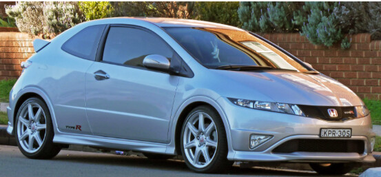

On the other hand, there are the Type R rims, but they go up to 19" or 20" unless you want the FN2 ones, which are 18" but have the same issue as the RX8, they look very outdated. Although it must be admitted that they look perfect on the FN2:

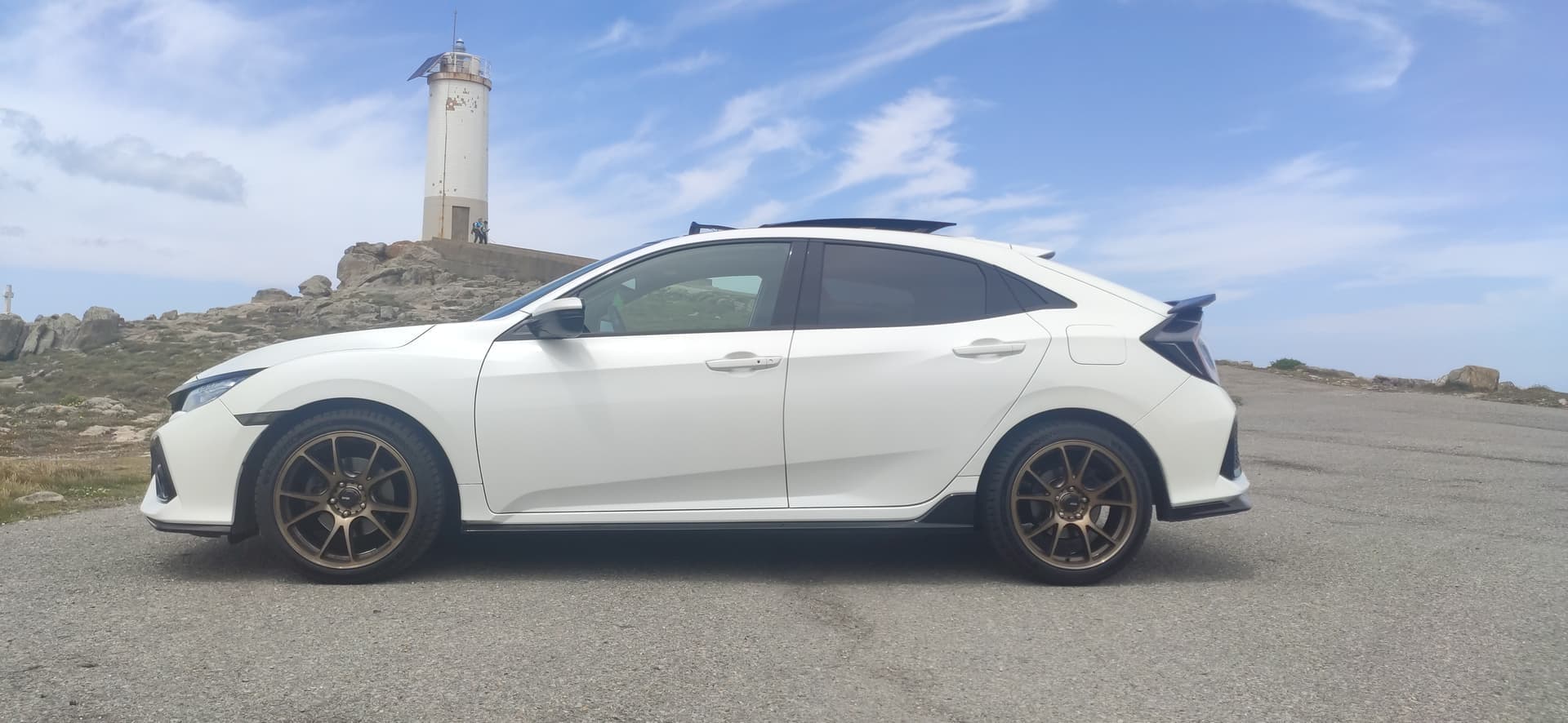

I have the König brand mounted in 18". They are light, beautiful, and at a “reasonable” price, or at least they were at the time.
Send a photo to see how it looks :smiley:
Here they are. They are in my post, they are the same ones that @Murcianico had/has. They are nice rims and weigh about 8.6 KG. However, the color is a matter of taste, although lately, I’m considering changing the color, as the bronze is getting boring for me… I bought them on a Swedish website because I believe they are American. They were also used on cars by the guys from Gears and Gasoline for trackdays, and in terms of price, they weren’t much more expensive than some Japan Racing or Jamón Racing depending on who you ask.

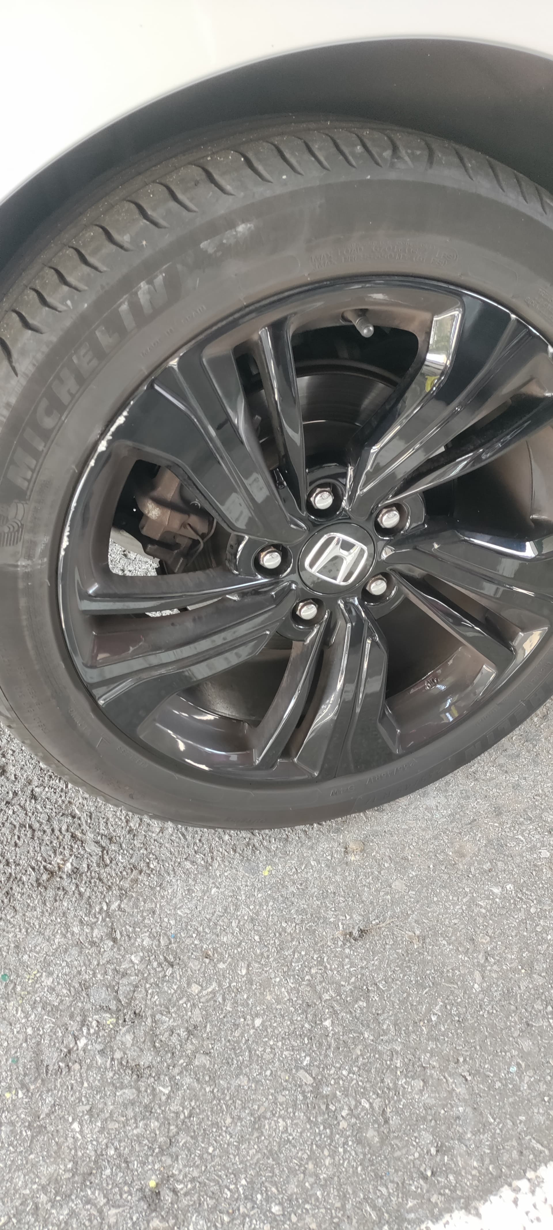

Do we know the weight of the stock wheels of the Sport Plus?
I really like the RX8 wheels, maybe a bit crude but they have their personality. And, you might kill me for this, but I love the multi-spoke wheels of the León.
The VAG group uses different bolts…
Yes, @Sirone weighed them, and he got 11.6kg.
22 kg with PS4 tires

The ones from the FN2 wouldn’t seem like a bad option if it weren’t for the fact that the ones being sold look like they’ve been through Sarajevo, Kosovo, and Iran, (even back in 2015 when I was looking for some for mine after an incident).
