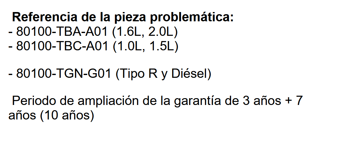

I disagree, if the evaporator (which is part of the A/C circuit) breaks, the warranty is 5 years from the brand and that’s it. I’ve experienced it myself and the repair costs more than €2000, and that 10-year warranty might be for the condenser and maybe the compressor, which back then, even with the latter, they only covered if you were within the 5 years.
There is a bulletin for the compressor with an extension to 10 years if it leaks from a specific site. The issue would be to know if your compressor had that fault or a different one. 26-10-2023 SX-09-001-01.pdf (569.0 KB)

Under the 10-year extended warranty, they have to repair it for you. They’ll replace the compressor or repair the condenser. That’s the information I have.

He llamado al 900 204 205 y me dicen que garantia de 10 años no hay para nada, que mi coche de agosto del 2018 no tiene ninguna garantia activa
Así, sin buscar mucho
11-07-2024 ST-09-002-07.pdf (263,5 KB)
Hay que leerse los boletines antes de nada.
