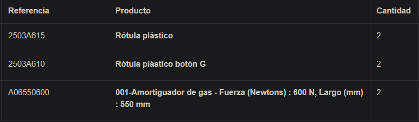

Hi, I finally found a site where you can order them with the measurements and force you want; they are from Pontevedra and arrive quickly.
You need to get these references

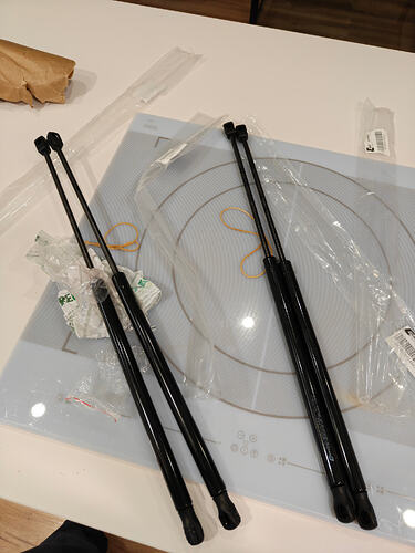

I bought both, that’s why there are 2 of each in the photo; with that, it has the perfect amount of force for me.
Otherwise, the Monroe M6330s or something like that which someone else posted above will work better, as they have a force halfway between the standard ones and the Type R ones, but with the dimensions of the standard ones. I think I’ll try those because I’ve never had to worry about clearance with the spoiler, so I don’t really need a shorter one.

@Sirone and I have taken a chance on the ones from Dyreparts (Casals brand); looking at them and touching them, they seem to be very high quality. I’m going to install them now; they arrived in less than a day.
Edit: I’m running the 550mm and 650Nm ones with the original Type R spoiler (which is a bit heavier than the replicas), and if you aren’t careful, at the end of the travel it makes a banging sound because they have a bit too much force; maybe the ideal setup is to put one 600 and one 650 (they recommend 635 for the Type R hatch). Other than that, they’re working great so far.
EDIT: After a bit of use, the final banging is minimal and sometimes non-existent, but the force they have is a real pleasure.
