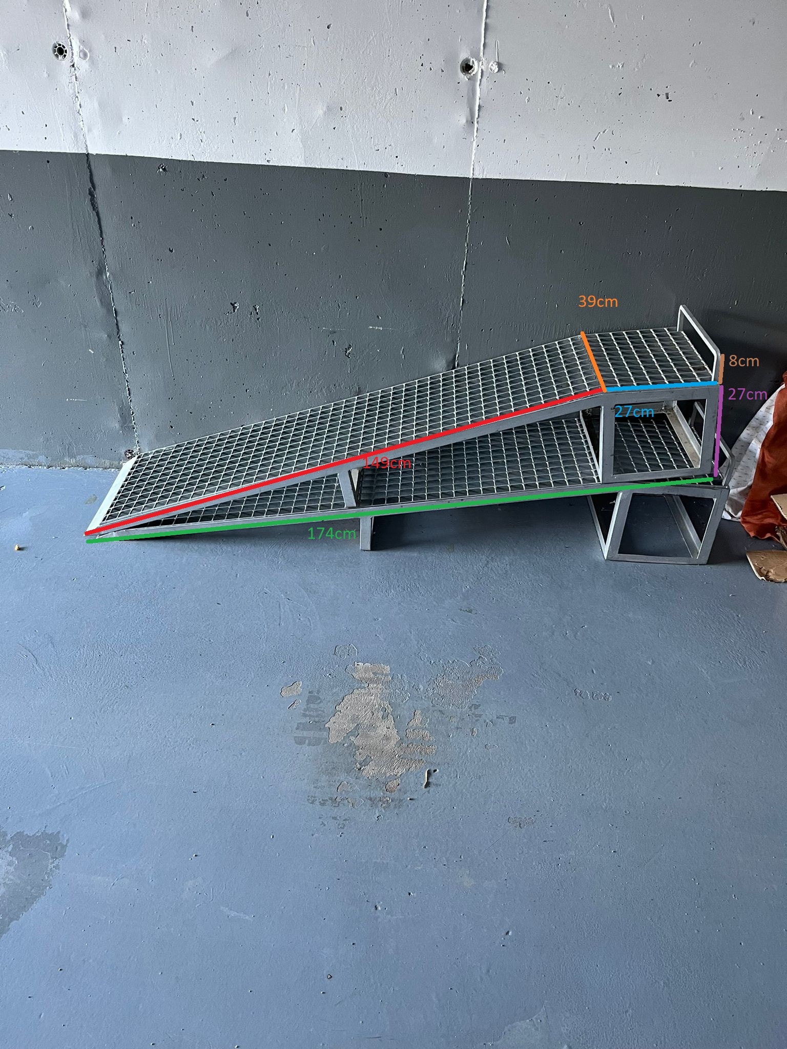

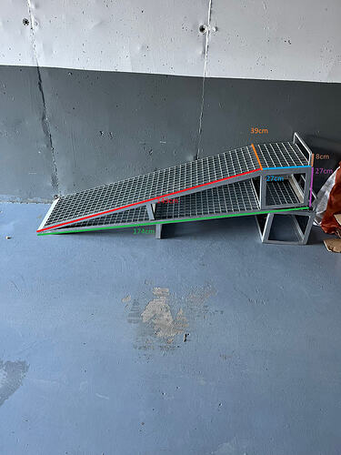

I had some metal ones made, since the ascent ramps were very steep; here is a photo with the measurements.
Great, thanks!
