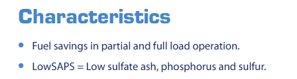

Regarding mid saps and low saps, the purists determine, no matter what, that if it has 0.8 sulfur, it cannot be called low saps. Although manufacturers say it’s a mix of 3 components and the oil you mention (l), they identify it as low saps:

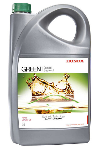

It’s something that shouldn’t make noise. It’s said that the 1.6 should use 0w16 oil instead of 0w30, but exclusively the Honda formula (it’s like the Coca-Cola secret).
From all this, it seems that there are two people who have used 0w16 and the noise has disappeared. Everything points to the fact that being an oil, 0w16, less dense, it distributes better and faster through the conduits… but as mentioned in the video I commented on, it might be another cause, changing to 0w16 seems to be a patch apparently.
Is it bad that it makes noise? No, but it shouldn’t.
By the way, is there a change in viscosity from the 1.6 of the IX to the 1.6 of the X? Because in the manual of the X it doesn’t say anything about 0w16.
By the way, does anyone have the PDF manual for the IX?

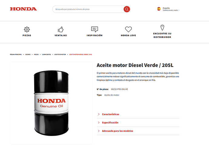

Not true about the canister. Aceite motor Diesel Verde / 205L - Honda Parts
Well, that’s what I understood… so, why do they use 0w30 instead of 0w16?
They used Castrol 0w30 oil due to a commercial agreement in Spain. Now, depending on the location, they use Honda oil. From 0w30
to the famous green, which supposedly has 2 versions, 0w16 or 0w20, or both.
If you talk to Honda, they say that depending on colder or warmer climates, one or the other is used. The thing is, in Spain, the climate is very diverse.

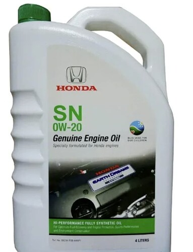

Honda Genuine Motor Oil SN 0W-20 4 Liters ( 1 Gallon ) Fully Synthetic | Lazada PH
Summary: use whichever one you prefer and doesn’t give you problems
This last one you mentioned; notice that even though it says Earth Dreams, it says i-VTEC (gasoline) underneath. I believe these are the 1.5 turbo i-VTEC (not sure about the 1.0 as well), so this oil is not suitable for the 1.6 i-DTEC.

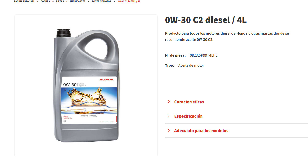

Regarding the Honda 0w30 C2 you mentioned: [quote=“mognet, post:108, topic:4052”] Honda oil. Of 0w30
a [/quote]
this is recommended for the 2.2 i-DTEC, links were shared here with Honda Europe’s recommendations for each engine.
Talking about oil depending on the climate… Well, it’s quite outdated nowadays, especially for the official workshop to say such nonsense. That’s what the thermostat, electric fan, and so on are for… to control the engine temperatures. We are not in Dubai or Siberia, where you would indeed need to be especially careful with temperatures.
Are their trade agreements as they have told you… According to what I’ve seen in the Civic X and IX manuals, it says exactly the same about the oil topic. None literally recommend 0W16, they say to use Honda’s and if not, a 0W30 C2 (or C3 if not). The thing is that it doesn’t specify well, nor is it certain what that oil is… I doubt it’s anything special.

Honda Genuine Motor Oil 0W-20 4 Liters 100% Fully Synthetic Approved by Honda Research and Development Suitable for ALL Honda vehicles Provides maximum engine protection at the highest speeds Reduces fuel consumption, tested with all rubber seals in the engine
If you go to the website and look at all the oils, you will see that they specify if they are only for gasoline use, not in this one. You will also see this: https://www.lazada.com.ph/products/pdp-i1540828843.html?spm=a2o4l.searchlistcategory.list.89.625624d9Jnv3xn It is recommended for all Civics from 2005 onwards except the Honda CRV diesel, which must definitely use 0W-16.
Let’s see, you’re looking at a website of questionable reliability, which seems like eBay, not anything official, and on top of that, from the Philippines. Where the Hondas are not the same as in Spain/Europe. Starting with the fact that I think the Idtec are only in Europe… It doesn’t seem even remotely reliable what it says there.

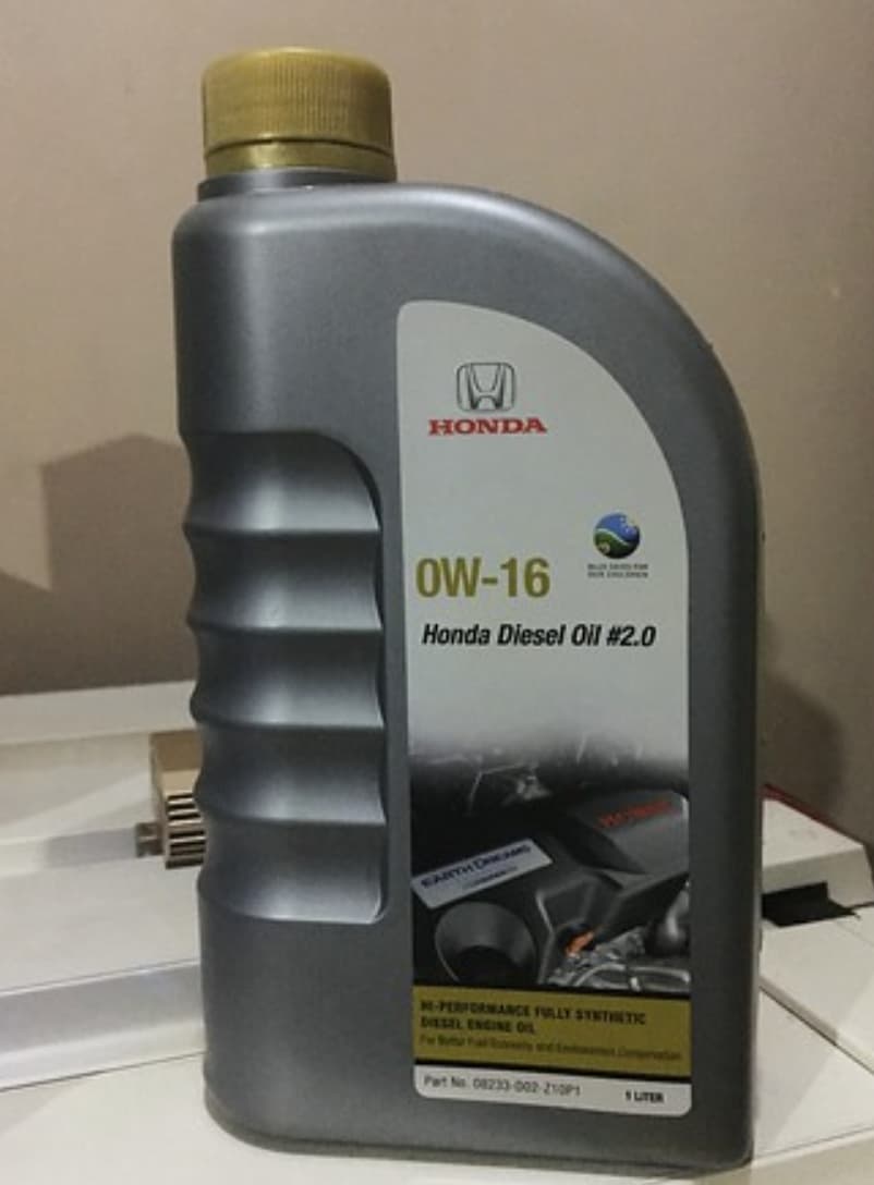

To not have i-DTEC engines in the Philippines, they sell and specify in their description that engine in 0W-16
Honda Diesel Oil #2.0 Fully Synthetic Diesel Engine Oil
HI-Performance
Specially formulated for Honda engines / High-Performance engine oil
BENEFITS:
  • Outstanding lubricity delivers better fuel economy.
  • Fully synthetic oil delivers optimum protection to your engine.
  • Reduce engine friction delivers better engine response and quicker acceleration.
  • The outstanding fuel economy delivers significantly reduces emissions.
APPLICATION:
For the i-CDTi and i-DTEC diesel engines, the recommended oil for Western European driving conditions and weather conditions is fully synthetic motor oil meeting the minimum specification ACEA C2/C3. The recommended viscosity is 0W-16 #2.0
SUGGESTED CHANGE OIL INTERVAL WHEN USING SEMI-SYNTHETIC OIL:
  • The oil change is for every 6 months or 5,000 km whichever comes first
  • Replace the oil filter to ensure there are no impurities inside the engine.
  • For more information call the Honda Service Center nearest to you.
IMPORTANT:
SN 0W-16 IS A FULLY SYNTHETIC OIL THAT IS APPLICABLE TO THE LATEST HONDA VEHICLE WITH DIESEL ENGINE
  1. Honda CR-V: CRV with Diesel Engine
As you can see, what they put there doesn’t make much sense: In the Philippines, only the 1.6 idtec has been released, yet they generalize for all i-dtec and i-Cdti (a 0W16 for a diesel engine from 2003, of course… It’s something very, very rare in the 1.6 idtec from 10 years later). They talk about using C2/C3 in 0W16 when these standards, at the lowest, are in viscosities 0W30. They recommend changing every 5,000kms - 6 months… These are very different things and recommendations from those in Europe. In the Philippines, they have other standards, and those engines can easily be different.
I am the first to use that image, of that oil, to “defend” that our engine can/should use 0W16, but I clearly state that it is still not 100% reliable. Something reliable would be an analysis (or information from a more or less official sheet) that the Honda diesel oil #1 (the one that is truly recommended in Europe) is a 0W16.
[quote=“mognet, post:115, topic:4052”] For the i-CDTi and i-DTEC diesel engines the recommended oil for Western European driving conditions and weather conditions is fully synthetic motor oil meeting the minimum specification ACEA C2/C3. The recommended viscosity is 0W-16 #2.0 [/quote] For the i-CDTi and i-DTEC diesel engines, the recommended oil for Western European driving and weather conditions is a fully synthetic motor oil that meets the minimum specification ACEA C2/C3. The recommended viscosity is 0W-16 #2.0.
WHEN USING SEMI-SYNTHETIC OIL: The oil change should be done every 6 months or 5,000 km, whichever comes first.
Specifying semi-synthetic oil in this case is not correct, as SN 0W-16 is fully synthetic.
I will give you my conclusions: As I told you, use the oil you want 0w30, 0w20, or 0w16. The green first version would be a 0w20, then it evolved to 0w16 in version 2.0. It cools better and improves consumption. It’s a full-fledged evolution that you can use or not, depending on your preferences. The standard is 0w30, from there oils evolved, and it was managed to lower while maintaining its protection. I will recommend the 0w16 because it is the one that suits best according to my experience and is what Honda currently works with.

You still have no certainty that it “would be” a 0W20, neither you know nor do any of us here. And as for Honda recommending that oil… Well, if you insist that it is so because it appears on a resale website from the Philippines. Look for some official reference from Honda and preferably from Europe. It wouldn’t be strange if in the Philippines those engines come without DPF or another type of post-treatment anti-pollution system. You were using the Honda Green diesel, right? I don’t remember for sure. So according to you, you continue with the previous version. Which, no matter how much you say, there is no real confirmation that it is 0W20 or anything.
Obviously, Chatgpt has no idea about this. Starting with the fact that it’s saying that the reference is 0W30 C2, either you told it that wrong or it made it up. Just with that information it has; the rest of the message makes no sense.
I told him I was using the one from the reference and the manual states that it recommends 0W-30, so I understand he made that assumption.
